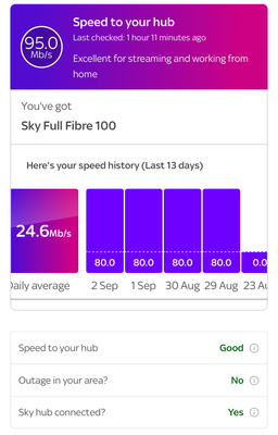

I had sky fibre 100 installed on 15th August after this was offered by Sky as a free of charge upgrade and was now available in my area. Up to this point we'd had no issues with our internet connection.
We have had intermittent issues with the connection dropping since and we are still having issues now. We keep getting told by Sky and BT / Openreach that everything is fine and is working. We have Sky WiFi max with the brand new hub installed. The lights on the ONT keep going off / flashing green / flashing red, then reconnecting after a minute or so.

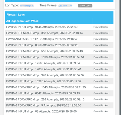

This affects me working from home and watching Sky glass TV etc. I have looked at the settings of the router, and after doing some digging on the internet and found these in the log. Could this be part of the problem? Is it a quick fix?
obviously with Sky 100, you are "guaranteed" 90mbps. Below is what we've had so far.
