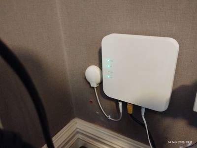

@SkybrokemyBB- Just waiting on your picture to clear, but is it back to a RED Internet light!
Picture has cleared now but it is the same one from earlier this morning, so not sure were you are at now!

@SkybrokemyBB- This is the most bizarre installation that there ever was, CF is just so new on the sky side but it is not rocket science, the ONT is looking 100% good and all green lights as you would expect, the SR203 was struggling to connect as it could not make it's mind up when it went to connect hence NO LIT internet light and was on Auto so trying to go out a VDSL copper but selecting it to WANoE made it go 100% out that Ethernet Port which it DID but still was not able to connect and went RED. The only factor that stands out is you have the XGS-PON version off the Nokia so it has way higher speed profile and will also have a lot Faster Ethernet port on it, but that should not matter to the sky Hub in the slightest and they should negotiate to the 1Gb/s port speed.
There is NO way that multiple sky SR203 hubs are all faulty, they are by far the easiest for a pure sky Connection to that ONT as you the user have nothing to worry about, plug it in let it connect and off it goes. What sky are doing is wrong they should NOT throw the hands up in the air and say that's it sorry you have an issue and we are deadlocked so leave and go elsewhere. You are kind off stuck now, me i would be connecting the laptop with an Ethernet cable direct on the ONT and seeing what is going on connection wise, do you feel that is worth a try let me know the other option is just to get your own Asus router and connect it up but it starts to cost you and although you will have some compensation eventually from sky, question CF Engineers when testing the CF ONT what did the connect to check and say ONT is good, we have let sky know now, they do have to provision the ONT correctly that is why they need to have all the details from CF to do it!
