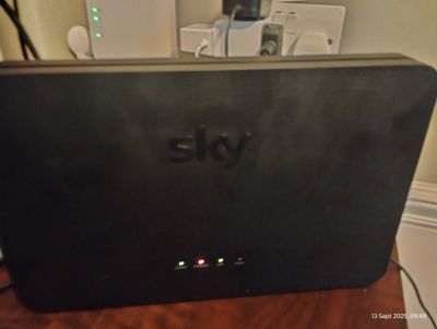

- Completed the line test, internet light on the HUB remains red. Received the following message post test ". I have long suspected a mismatch with the serial numbers between the ONT and the HUB. I keep getting conflicting advice on the importance of the serial number matches. I can't get someone from SKY to definitely state exactly which numbers have been entered onto their system. They just keep reciting the numbers that I gave them which is no assurance that is what has physically been entered on their system.

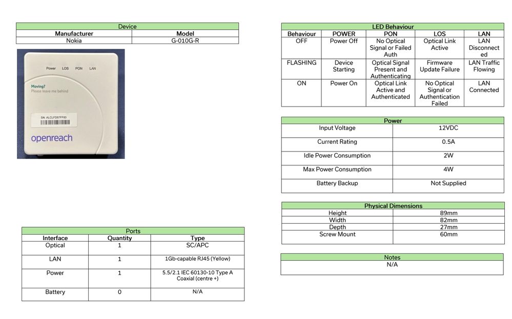

@SkybrokemyBB- Although you have the CF Version off the Nokia Modem ONT so probably black in colour, the lights on it,
1st from the left Power Solid Green.
2nd Los unlit
3rd Pon Solid Green.
4th Lan flashes as the Sky Hub - ONT send data back and forth!

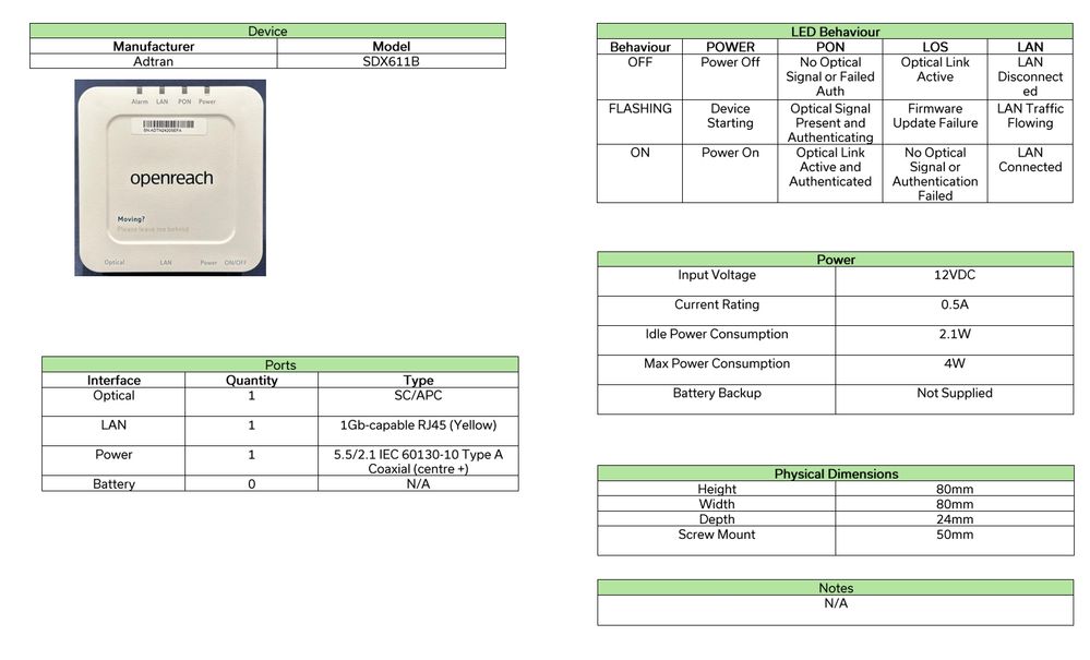

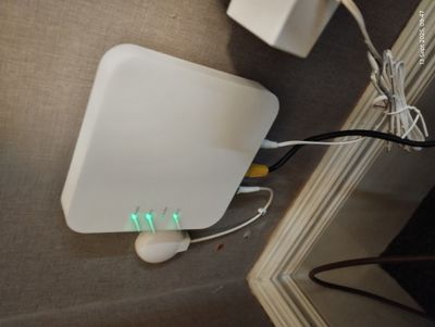

The particular Nokia ONT Box I have is white in colour. Lights top to bottom;
1. Power (steady green)
2. PON (steady green)
3. Alarm (no light)
4. Data (blinking green)
The previous CF Technicians state this is how it should be
Message posted on 13 Sep 2025 12:36 PM
Re: No internet
@SkybrokemyBB- Correct sequence, obviously a different type from what OR Use,, There Adtran version is the only one that has Alarm written on it!
