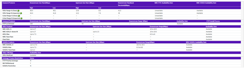

Could you post your hub stats
And enter your full postal address below and post the table after removing your address from the image

There only appears to be a small fault as shown by the noise margins although the speed shows a major fault.
To get you assistance i will escalate this for you

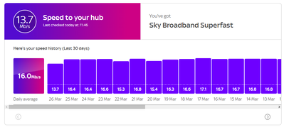

26/03 Update:
Had two sky employees lie to me, saying they ran a scan on the line and it all showed up fine. Finally got through to someone on the complaints desk, they ran a scan and it showed up with a line fault outside of the property. Openreach arrived today and crimped a loose line, not sure whether it was up the pole or supply box. The landline has since been working.
I wasn't home at the time, but apparently he was ready 55mb/s - I am getting less than 14.
Is it worth giving it a few days, or is this worth contacting Sky again and hoping for a decent employee response? Or am I within my right to cancel my contract within the minimum term due to the issue without fees?

After a fault fix it takes around 48hrs for your throughput speed to come back.
We can already see that your router is showing the improved line speed of 55mbps so you should be able to get that speed via ethernet after 48hrs.
