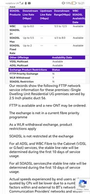

Message posted on 19 Jan 2024 04:24 PM
Re: No ONT
Message posted on 19 Jan 2024 04:45 PM
Re: No ONT
There should be a WBC FTTP row . What does it say ? Can you post the entire row.
What that indicates is that there does not appear to have been an ont so it should be installed on thd day of activation
Message posted on 19 Jan 2024 04:48 PM
Re: No ONT
The text under the table shows there's currently no ONT, and that optical cable is going to come in through an underground duct. This means there will have to be at least one installer attendance at the property, and perhaps two or more.
Message posted on 19 Jan 2024 04:52 PM
Re: No ONT
Also note that typically means there will need to be drilling through a wall to get the new optical pigtail from outside to inside, plus wall mounting of an external CSP and internal ONT.
