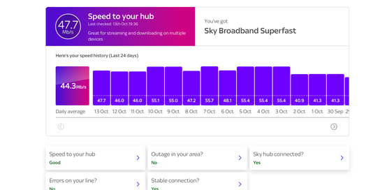

Message posted on 20 Oct 2025 06:04 PM
Re: Low noise margin, do I need an engineer?
@Chrisee there is no different in speed if I disconnect everything, here are some of my previous speeds. I'd like to get it back up to 55mb
Message posted on 20 Oct 2025 07:19 PM
@klaudiaaa As long as you have not been switching the unit off and on intentionally, which is bad to do on a copper line, then looking at the stability against time, looking like the DLM is fighting a potential bad copper line from the cabinet to your home. If you have a ADSL filter and the OR Master socket is a type 5c would be popping the front off and trying the filter on the test socket hub connected that way!
Message posted on 20 Oct 2025 07:59 PM
@JimM1 I may have switched it off a few times when speeds dropped if I'm being honest
Message posted on 20 Oct 2025 08:07 PM
@klaudiaaa Switching off is OK when you see the Internet light off or Amber, any other time it's a NO NO, you can introduce the stability doing that and then you have the 10 day wait while the DLM takes steps as best it can, Stability is it's whole aim in life even if it drops the speed all the way down to minimum, then slowly picks it back up again!!! Nothing you can do but try to be patient to see if it auto recovers!
