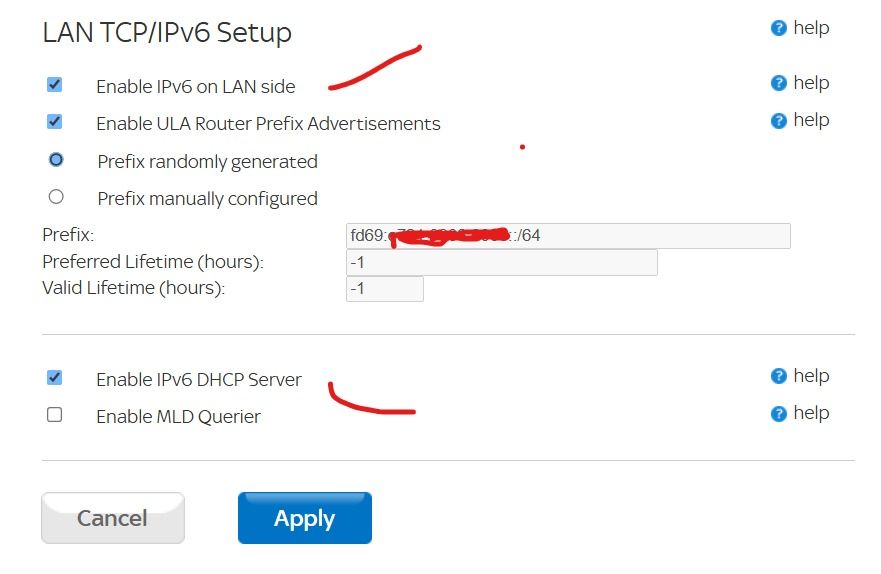

@scotsy0727 Well mine had it on the get go way back in march, you can disable it if you wish to try, you just need to use the web manager, 192.168.0.1 will get you there, if you are using a phone then best off luck, laptop will be way better, Think you will find it in advanced, NO SR203 connected but may have some screen captures if i need to look!

I'm on my laptop and in the router settings, under Adanced I cant see anything close to NO SR203. If you have screenshots that may help.
Re: Issues with ipv6-first
@scotsy0727 Here you go, will need to be cleared before you can view.
SR203 advanced and lan tabSR203 advanced and lan tab
Got me to what I needed to try but unfortunately did not work to get my work laptop connected to the router.
