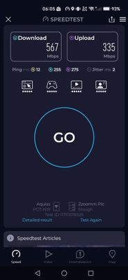

Ps .... have reasonable expectations of WiFi speeds depending on device and distance from hub and mesh nodes eg is the following good or bad speeds on a Honor Magic 5 pro on a 1GBps connection? Same test on my iPhone 16 plus is 140/119
