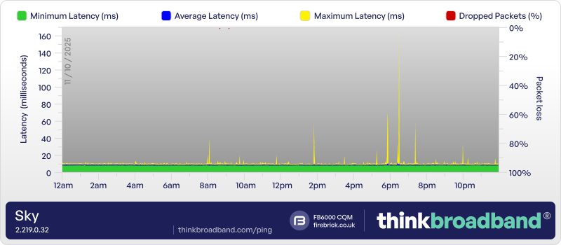

@Waveman Thank you - funny enough, I completely forgot that I set up a monitor several months ago when this was first starting. Here is a graph from a couple days ago - not totally sure what to make of it but I'll do some reading:
I've also set up a monitor for the new router now so will see what that says. Thanks for your help.

@fullfibredown Hide your IP below the Sky when you post and attach your pictures! Looks good for that day working well!
