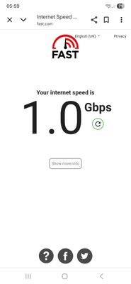

Message posted on 09 Sep 2025 06:01 AM
Re: Gigafast plus
Message posted on 09 Sep 2025 06:07 AM
Re: Gigafast plus
Hi, thank you for all your replies, really appreciate it.
Seems like good speed standing next to it, which is strange when my tv and pet cam are in the same room.

Message posted on 09 Sep 2025 07:14 AM
Re: Gigafast plus
Message posted on 09 Sep 2025 07:17 AM
Re: Gigafast plus
@Vickib7 Once the picture you posted is cleared for viewing will take a look at it, do not know much about that wi-fi7 hub apart from the specs as it is so new and not much posted about it on the Forum yet, the pod's if still the same that sky are offering with the unit were estimated to be wi-fi 5 devices and they opened up a 5Ghz seperate backhaul channel, and as far as i am aware NO light is good operation with them so the sequence that you say i do not know as have never used those devices, but would say that i would move it, the pod's ideal position is midway between where you need the wireless wi-fi to be and the hub, but NOT too far away from the hub as it will struggle to connect and pass data accross to the device location.
