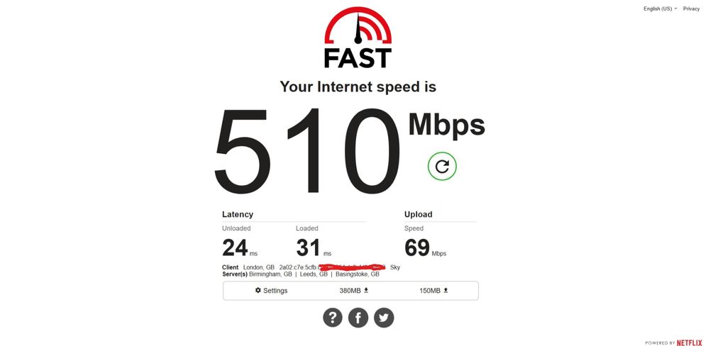

@Kenny+J The SR203 is a wi-fi 5 hub, and ethernet connected yes you will get the speed expected but on wireless connected, close to the hub then about 600Mb/s is the max and that is at a push, 500Mb.s would be the more expected....
And all assumes that your devices are at least capable off maintaining the required speed's.
Speed test above is on the sky FF500 feed, and connected wireless to the SR203 hub about 20foot away.
