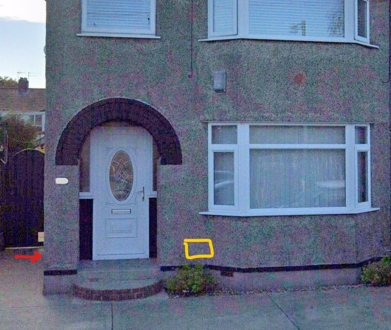

I have upgraded from Sky Broadband to Fibre, and have my installation date. Having watched the video, I am concerned about wether this is actually going to be possible.
I have been in my house 14 years, and the BT socket in my hallway has an extension socket, of which the cable runs underneath the floorboards in the hallway, underneath the wall and floorboards into the lounge. This is how it was when we bought the house. This feeds the extension socket into my lounge, of which it sits next to a double socket. I have my router placed there as it is the most central point of the house. I have heard arguments that an extension decreases speed and reliability etc, but I've never experienced this as I pretty much get the adverttised speeds from my broadband.
The question I have at the moment pertains to the actual installation of my Fibre equipment. I imagine that the reason the extension socket was put in was because there are no mains electrical sockets in our hallway, but I now know from the Q+A video that there needs to be a double socket where the fibre comes into the house. My concern is that as I don't have a double socket, I won't be able to have the install-is this correct?
In relation to adding a plug socket into the hall, I'm fine with electrics as I often do my own as a 'competant' DIY'er, however, the problem I have in my hall is that the laminate floor that I have runs from my hallway (starts at the front door), but runs all the way through into the kitchen, so getting the flooring up to come off the nearest socket means taking up the whole floor, starting at the kitchen end-which obviously I can't do (I only laid the floor 2 years ago).
I live in a 30's semi, and I do have a double plug socket that I fitted on the nib next to the bay window indoors-would an engineer be able to run a cable from the side of the house round to the front and drill the hole there? In the attcahed picture, BT have fitted the little grey box to the side of the house where the red arrow is poiting, the socket on the nib internally is located roughly where the yellow rectangle is. In my head, as the grey box is fitted near the front of the side of the house, it falls inline with the porch, so I wondered if the cable could run around the inside of the porch, and through the wall so it comes out near the internal socket. Is this something that could be done? I don't really want to have a cable runing around the inside of the porch, but if I know it's an option, I can buy some conduit and prepare so as to make it neat (i;ve recently rendered my porch and it's all painted black, so wouldn't be too noticeable).

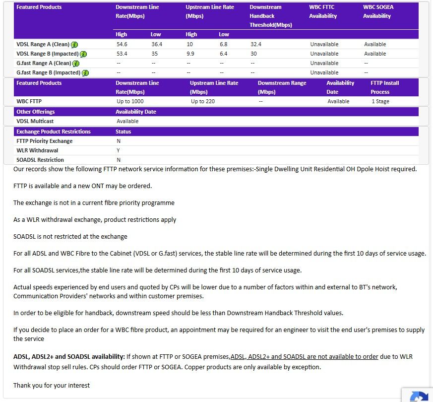

Could you enter your full address in the link below and post the table and notes after removing your address from the image

Message posted on 12 May 2025 11:35 AM
Re: Fibre Installation Options
Overhead feed with a hoist . So no need to lift the floor boards

The fibre will come to the house from a telegraph pole using a hoist before coming down to an external grey csp box before been drilled thru where an internal ont will be fitted 10 metres from where the fibre enters the building and 3 feet from the nearest electric socket. However this can be negotiated on the install date if there is no suitable electric socket

@cookiemonsteruk I see. Does it matter though that I have already had the grey box fitted to the outside of the house though?
Message posted on 12 May 2025 11:57 AM
@Danorak Not really as you said, outside wall is the easy prefered OR/Contactor way, less hassle, you have the problem pushing the wireless signal through the property now. Fibre is delicate that is the main issue, moving the Box on the side is a complete pain, time for the Installer talk when that happens. But you have it all sussed regarding what you need, and central position you got it all correct....

In the table at the end of wbc fttp it says 1 stage install which usually means external and internal work are done on the same day. So it looks like they will only be coming to install the ont and splice it to the grey box. So it would rule out placing the csp in a different location but does not exclude running a longer length of internal fibre pigtail to a better location. Openreach would prefer any such work to be done along, for example, the skirting boards as opposed to lifting the floor. Any existing copper cabling will now be redundant and seperate from how they install the fibre pgtail. You could always speak to openreach on the day
