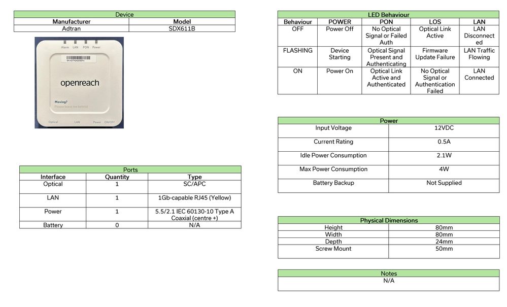

@Lynne+Watkin The ONT box from Openreach below.
The Adtran ONT version.....
Normal working condition is 3 Green Lights.
1. Alarm always out, you never want to see this lit if it does then will go RED you have a problem.
2. Lan flashes when data is sent back/forth between unit and the hub.
3. Pon always a solid Green if flashing you have a problem.
4. Power solid Green.
From the table above the LOS that you see, just use the Alarm as the reference oops in the table thats all....
