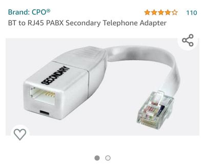

Did you manage to get a resolution to this? I'm in a similar boat, I'm using a Draytek 2862 and have the internet working a treat. Only issue is the VOIP connection, as the WAN connection is going into the Draytek and not the Sky Hub. Has anyone tried an adapter? Or is this not likley to work as the VOIP traffic is hardware specific to the Sky Hub ?
Message posted on 09 Dec 2021 10:59 AM
Re: External VOIP Connection required.

That's a simple passive wiring adapter which is intended to permit digital phone handsets to use structured cabling (ethernet) in a business environment to reach an onsite PBX. It can't do anything at home with VOIP.
The relevant device would be a VOIP ATA, but unfortunately Sky don't publish the required configuration details.
