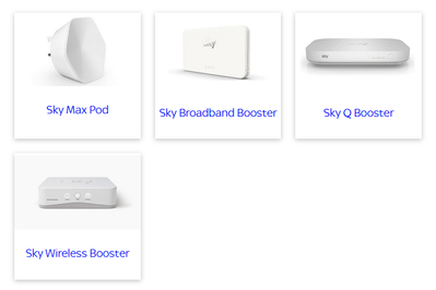

Each generation of Sky Hub has a matching booster release.  There's some crossover between the Q Hub and Sky Broadband Hub because those are both 802.11ac

The first part of my statement is simple fact, as illustrated.  The second part is based on experience in this forum.
The now-obsolete 2013 Sky Hub was 2.4Ghz-only 802.11n with a matching single band booster.  The 2023 Max Hub is 802.11.ax and designed only for its accompanying 'pod': it has a different software stack to all previous Hub hardware.  Both the 2016 Q Hub and the 2019 Sky Broadband Hub are built with the proprietary 'Q mesh' technology of that era.

@Rob256 the matching booster to each model of black hub is a similar shape but white as the picture @TimmyBGood posted.
Sky have not sold boosters for several years and all of the stock that matches your SR203 were loaned so should not be resold but some leak onto the used market. However Sky dont have help pages explaining what works with what as they send the correct model out to customers who qualify for a new booster - ie buying a bundle like Broadband Boost or have Sky Q boxes that are not connecting properly.
Because the SR203 supports the Sky Q mesh wifi networking they  need a booster with similar support.
