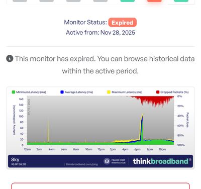

Noticed the internet was being slow on an evening when I came to use the internet around 8pm. I have joined the 500 fibre package on the 28th October and have noticed this ever since, the drop outs go to around 1-12Mb

Carried out a BQM for 2 days, for one of those days no one was in the house. Speaking over text to the open reach engineer and supposedly they will test it tonight, but they are also asking questions if a VPN is used or it might be my hardware which I feel I have ruled out. Unsure what else can be done here so I would appreciate any and all advice or help.

@DisgruntledGrey You still need to switch everything else off to prove it though!
BQM everything connected

@DisgruntledGrey So what is you BQM running against then, the sky Router or the PC?

It's pinging my router to the thinkopenreach server. Pc is turned off.
When I go on my computer in the day it works great, just when it gets to 6pm it turns nasty.
