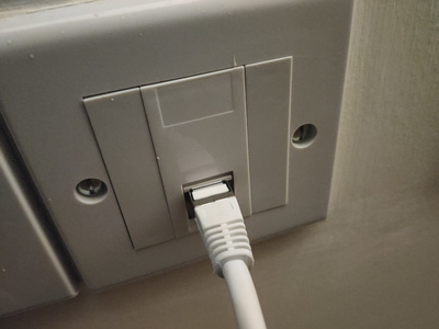

PHOTO 3: There are RJ45 plug in my living room or my different bedroom, which is a good sign I guess. I tried to connect an RJ45 cable here, pluged the other end on my sky HUB but it's not working, Sky Hub persist to show red LED.

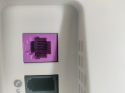

PHOTO 4 : I feel like I need to connect a cable from the purple plug on my Sky Hub to the RJ45 plugin my living room but I have no such cable for that??

The purple socket on the Hub is for the internal VDSL (FTTC) modem: it has no involvement in FTTP.

If you have a cable route over in-wall cabling, you can go ONT ethernet port 1 to wall port, then wall port to Max Hub (ethernet port 4) in another room but that must be a contiguous connection.

So... I can't install my SkyHub on my TV cabinet by using the RJ45 socket that is on the wall of my living room ?
Message posted on 06 Jan 2025 07:27 PM - last edited: 06 Jan 2025 08:06 PM
Re: Completely new to UK broadband, can I put my Sky Hub anywhere in my appartment ?
Only if you can figure out where the other end of the cable behind the socket is, and patch that back to the Openreach ONT.
This is assuming there's actually a contiguous cable in the wall, though: unfortunately it's quite possible it's not there, is unterminated at the other end or just runs pointlessly between two arbitrary locations.
My suspicion is builders and refurbishers put ethernet sockets in as a minimal cost 'value add', but without a legitimate topology it's useless.
