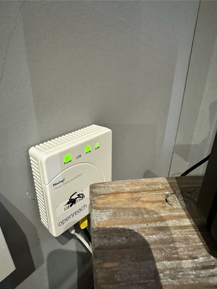

This my set up into the router if that helps.

@oomanpooch the Asus RT-AXE7800 should work with your Sky service. However remember extending wifi coverage to your extension may well still not work that well. Wifi signals especially the high frequency signals that these routers use to communicate with satellite units do not pass through external walls at all well.
Running a simple ethernet cable from the router's location to the conversion and installing a wifi access point there would definitely work.
