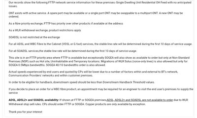

Could you enter your full uk address in the wholesale checker copy and paste the notes below the table it will show whether an ont was there

Hi,
It won't let me copy and paste but does this work? Many thanks

This message was authored by: cookiemonsteruk Answer
Re: Broadband ONT instillation
@JamesMcCaffrey
Yep openreach think an ont exists withan active service.  So call sky on the day of activation to request an ont
Contact sky as below
Follow the link and choose need more help
https://www.sky.com/help/home/
If in the Republic of Ireland go to the bottom of the page and change the flag to Republic of Ireland
P.S i cansee the notes and about to moderate them
