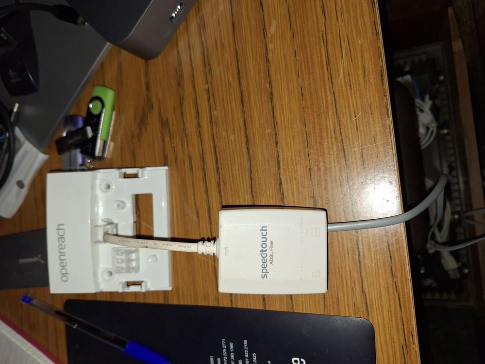

@AJA66 See pictures once they clear.
1. To remove press here. And pull forward.
2. What you see the test socket middle top above the rectangle hole!
3. The ADSL Filter
4. Plug it in and connect up the hub, Grey cable!
Message posted on 25 Aug 2025 08:11 PM
Re: 4 months of dropouts and unusable upload speeds
Thank you very much I will try that.
