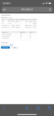

@KP61 can you post your router stats if you are not sure how to do this have a look here

Sorry for the late reply, is this what you were asking for

If you copy and paste the stats it will bypass the moderator

Thats typical of a adsl line some 4km from the exchange. The only option is to see if fttc superfast is available . If you enter your full postal address below and copy and paste the full table we will be able to advise

Your likely not going to get near the full 3mbps speed of your line due to the low upload speed. Anything sending data will saturate the connection and limit your download speed. You should look at getting fibre as speeds can be a lot higher.
