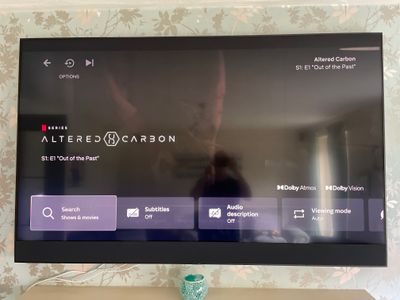

Am I just being dumb, or am I correct in that when playing Altered Carbon on Netflix, with Dolby Amos and Dolby Vision active, the picture settings are all irrelevant as Vision takes them over?
reason being is that all the settings from Auto to Custom do nothing when watching this content.
Also, interestingly, when the film is playing and you are viewing the Sky Glass home UI you can see the backlight change as Vision controls it.
is this normal‽

@discodancers on most TVs by viewing content with a Dolby Vision that flag will switch the TV into its custom Dolby Vision mode with settings optimised for thst content. So for example the backlight set at max and white point set etc. Some TVs allow users to change that settings without altering the SDR picture simply dont know if thst is possible on Glass.

Message posted on 27 Oct 2021 01:09 PM - last edited: 27 Oct 2021 01:11 PM
Re: Dolby Vision and Custom Picture Settings
is this normal‽
If it's Dolby Vision IQ, yes.
The way Dolby Vision IQ works is by using the dynamic metadata encoded in Dolby Vision content in conjunction with an embedded light sensor in the TV, using the information to change the picture settings and display a more accurate picture.
Basically, Dolby Vision IQ can tell that you’re watching TV in a brightly lit room, where lots of dark details are getting lost. The TV will therefore be able to boost the brightness automatically without you having to go into the picture settings and do it yourself.

@TimmyBGood @Chrisee thanks. So the only setting that seems to be available is the Dolby Vision Picture mode - Dark to Bright. This actually does something.

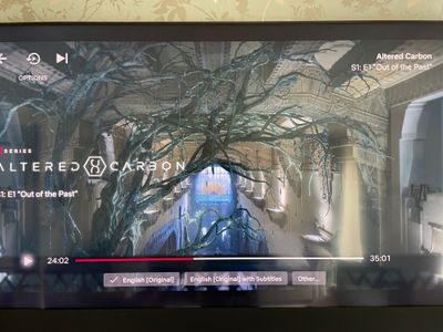

Message posted on 27 Oct 2021 01:15 PM
Subtle differences...

@d2hHowever the Program is dynamically changing the backlight during the Vision film. Is this the local area dimming working?

Dolby Vision capable TVs usually have preset modes labelled Dolby Vision Dark, Bright or Vivid, along with Film-maker mode sometimes. These will over-ride any user settings for other forms of HDR, though can be tweaked on some TVs, but probably not on Glass.
The backlight variations you are seeing are to do with local dimming, to try and keep the blacks looking blacker. On some TV's the dimming algorithm can end up being distracting so personally I turn it off, but I don't know if this is possible on Glass. It is possible on Panasonic TV's.

@fizzdisco You can switch local dimming off on sky glass. However it makes Altered Carbon on Netflix in Dolby vision look a bit too uniform. Personal preference I guess

@tarbat Only bright and dark settings. I'm in Lincoln. LOL.
