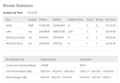

Router Stats (Thoguh not sure if youll be able to see them as my posts need moderation I think)

According to your line attenuation d3 is just outside the viable range to register any speed on that spectrum.. at the minute . May be after 10-14 day dlm that will fall within a viable range. Also what were you given as a minimum guaranteed line speed. ?

Line attenuation of above 60-65db on ds3 will not produce any speed. But is important to get it registering as in ideal circumstances ds3 can account to up too 45Mbps of your speed. So leave it for a while and get back to us if nothing has changed. By the way what is your minimum guarantee?
