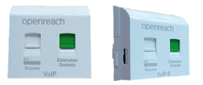

a Sky engineer has said that she needs a splitter and to run a cable all the way from the split at the back of the router to wherever she wants the second phone to be even though a splitter is not currently available to do this.
I suspect that was a clumsy attempt to explain 'Voice Re-Injection', which Openreach prototyped a specific faceplate for but appears not to have manufactured in any quantity.
