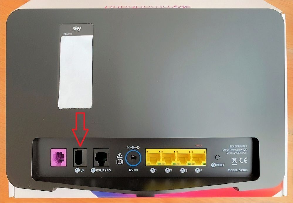

@Delta990  Yes the phone line is now VOIP, but you just plug in your normal phone into the back of the router as shown in the picture below.

@Delta990 Sky isn't a native VOIP provider. The only access to Sky VOIP is through the ATA within the Hub via,the telephone port, as @Highlinder posted. You can, of course, sign up with a separate VOIP provider and use your IP phone to connect via Sky's broadband service.
