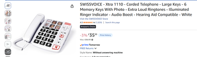

Hi
Unfortunatley that is not the case. He has a panasonic dect phone system that works fine on the system but we need a desk phone with picture buttons on for his disabled wife and the 2 i have tried do not work when pluged in to the phone line.
this one worked fine until he went to full fibre broadband and Sky changed the type of phone line.
i have just bought this phone but it is the same.
i think it maye be due to there being no power on the internet line not like the old system.

my understanding is a phone like that should still work with Digital Voice, I know you mentioned there being no power on the new system but that shouldnt make a difference, does the phone not have batteries ? quite a lot of them still need power in addition to being plugged in.

@Mark+r+Gibson sorry to hear that. As the DECT phone works ok, there wouldn't appear to be a fault with the internet calling service provided by Sky.
You may be right that the big button phones require more power than the Hub can provide making them incompatible, though I notice that the set up instructions for one of the phones indicates that it's designed to work from an 'internet box' which I take to be a router.
You might want to talk to the phone manufacturers' support people to seen if they can shed any light on it. Alternatively, look for a big button which is externally powered, perhaps, rather than relying on the power provided by the Hub.
