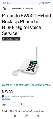

We're currently in this situation, no broadband & hence no phone. Mains power is not the issue. I'm concerned about my elderly parents & thinking of buying them a Motorola FW500 backup phone (as mentioned above).
Question is: how do I connect that & their cordless phone master station to the Sky Broadband router? There's one Brit & one RJ11 socket in the back. Would a splitter in the Brit socket work? Or an RJ11 socket to Brit socket converter?
I agree, Sky are going to lose business if they don't provide a solution to this!
Message posted on 02 Apr 2026 09:18 PM
Re: Do sky sell Battery Backup packs for their VOIP telephone service?
@NigelCro yes, you can use a standard BT splitter. However, as @TimmyBGood's posted earlier, a Motorola FW500 is designed to work with BT/EE's proprietary Digital Voice service, but not with Sky Talk.

But u said there was no broadband, so this phone won't work anyway without broadband. A basic big buttoned mobile phone that will be easy for your parents to use would probably be the only option now that the copper landline connection is off and phone sockets no longer work.
If u mean that u have now got fibre broadband in your parents house and wanting to connect a 'landline' phone to the router that will work if the electricity goes off and the broadband connection is therefore off too, then this seems to be the only one on offer from EE/BT/Virgin Media, but as said by the other poster, this will not work with Sky broadband services. Sky STILL don't offer anything like this for their Sky Talk service, but even if they did, this hybrid phone just connects straight into the 'phone' socket on the broadband router and has a plug on it to be plugged into the electrical socket constantly and then if the electricity goes off it would be fully charged and it has a mobile sim in it to become a basic mobile phone, as such, but just looks like a landline phone.
