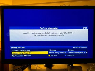

I had the card out of the box overnight and the box turned off at the mains, but when it was started up again this evening Sky News 501 was still showing as HD, as was Sky Arts....
Each channel showed the For Your Information box "Insert your viewing card".

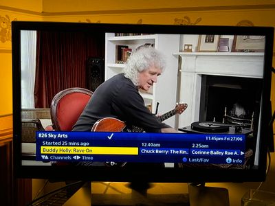

The following pics are for Sky Arts: Card not inserted
Card inserted
Ch 130 With card
Next, card in or out - no difference, just the channel number is wrong.
Ch 826 with/without card
