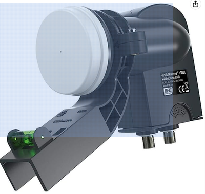

Thanks GD1, so i could replace the LNB with something like this ?
Re: No satellite signal on my Sky + Box
@Simon70  The LNB you posted is a wideband, they are not compatible witb Sky + It needs to be Hybrid or Universal for Sky+ (Hybrid would allow Sky Q to be used again if you returned in the future).
