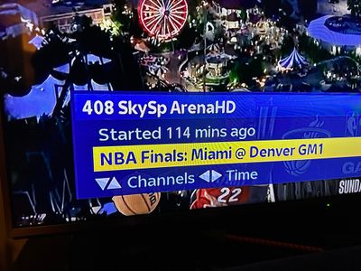

Not quite - by grainy, I mean there is a general noticeable 'noise' throughout the whole picture compared to how it normally looks, especially where there is high contrast - e.g. the blue menu bar with the white/yellow text is particularly noisy.
TV is connected via HDMI through a sound bar ARC, although I've tried connecting directly to the TV and the problem persists.

It's very hard to photograph the issue, it most certainly doesn't look as fuzzy as it doesn't to the naked eye! But you can just about see almost a glow around the letters caused by aforementioned 'noise'
