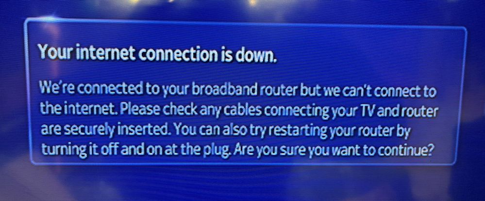

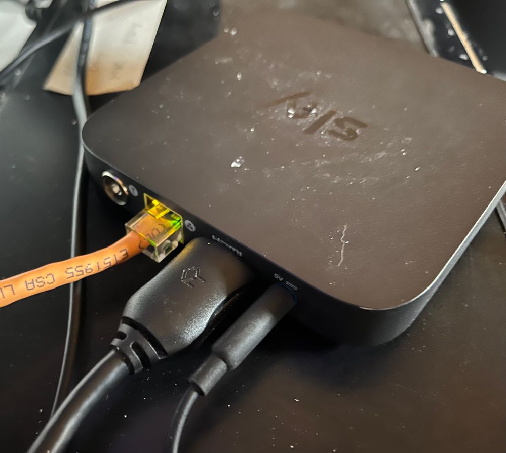

I'm trying to move my sky puck to my man cave in my garden. I have a TP booster on the same power line but it won't connect. I've used Ethernet as well as trying non cabled. Any help would be greatly appreciated!

Sorry just seen your photos - is that a powerline adapter ?
try a different ethernet cable in case you are using a "cross over" cable and not a standard ethernet
also just for ref you need a pair of powerline adapters .... the other one needs to be plugged into the router
Message posted on 19 Mar 2025 11:32 PM
Re: Sky puck in an out building
The photo of your AV600 powerline extender box shows that the LED indicating that it is connected to a powerline network is extinguished. Ensure the extender is plugged into a wall socket in the outbuilding and not an extension lead. My guess is that you either need to pair it with the powerline adapter that's connected to your router again, or the power to the outbuilding is not on the same circuit as the router {so it can't communicate via the mains wiring). If you don't have the instruction book to hand you can get a PDF version here - https://static.tp-link.com/2020/202008/20200824/1910012821_TL-WPA4220(EU)_UG_REV5.0.0.pdf
