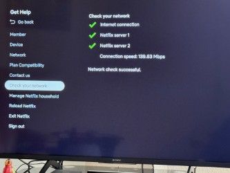

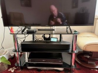

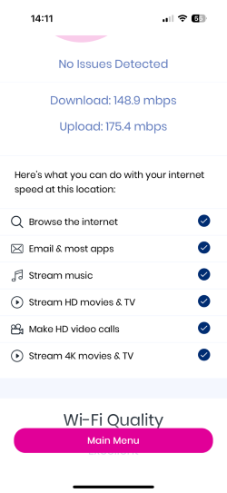

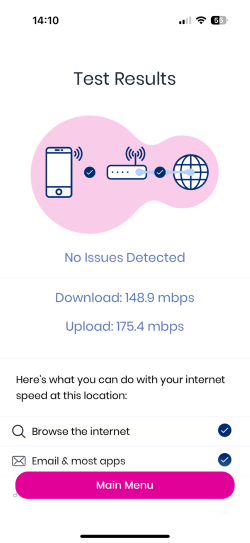

Thank you for your comments and help.  I now have some understanding that the Sky Stream Puck demands more from the internet than the Firestick.  I am considering increasing my broadband speed to the next level i.e. 500Mbps?  Do you think this will be beneficial?
I've attached some photos showing my current internet speeds - one of the TV showing the speed per Netflix on Sky Stream, the others per my phone in the same room.
There is also a photo showing where my puck is now located - I have moved it further forward on the shelf but with no improvement.  You'll notice that the shelf is glass but I dont understand why this should be detrimental

If your speed at times using that Netflix speed test on the puck is mostly that, it does seem like you are suffering some local interference.
Not seeing that an increase in speed will help you, it's your local network or some interference most probably causing an issue.
Glass can cause issues with allowing wifi devices to travel. Sometimes, just setting on a wooden block on the glass helps.
But, looking at your last picture.
Could you try for testing moving your Sky Stream puck away from near or under the TV ( it's too close if I'm honest) and away from those other electrical devices that sit below the puck.
I would say set it on a table to the right or left of the TV, say a good six to twelve inches to the side of the TV, if possible and at least one to two feet high off the floor. It does not need to be any higher than that.
I did some tests in my home setup, that has been very reliable for Sky Stream way back and if I move my Roku within about four inches of my puck, both sitting on the same shelf, my Sky Stream puck wifi speed drops intermittently quite dramatically.
