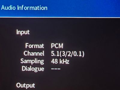

Message posted on 02 Jan 2026 06:59 PM
Re: Sky Stream - PCM from iPlayer etc received via passthrough as a Dolby signal?
Did some testing and the Yamaha AVR is reporting that sky stream box is outputting 5.1 PCM when using passthrough. However only 2.0 is actually being output
This is why Dolby surround won't work, because the AVR believes there's nothing to upscale
Message posted on 02 Jan 2026 10:42 PM
I had the exact same problem. All stereo output from the puck was telling my Yamaha AVR that it was 5.1. Setting the output to 2.0 worked okay, as did Dolby Atmos.
