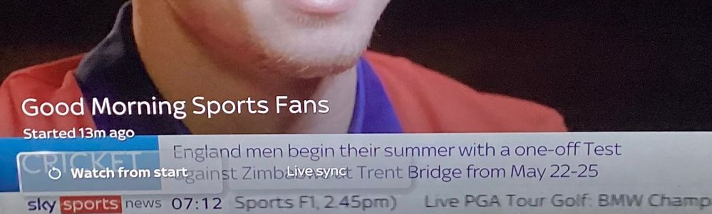

The firmware update QS030 that brings the low latency switch landed on my pucks overnight. With the update if you tune to ch 401 Sky Sports Main Event after a few seconds option to either start again or Live Sync appears select the latter and the programming switches to ch 921 or 922 depending on whether you are watching in HD or UHD. Seems to work well as long as you have a reliable data connection as the system reduces the resiliance to interference etc of course you can stick with the standard stream if the low latency stream gives you issues.

A photo of how the Live Sync option sits on the lower left of your screen, next to the Watch from Start option;
