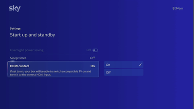

Message posted on 24 Jul 2025 08:35 AM
Re: sky puck remote
Message posted on 24 Jul 2025 08:55 AM
Re: sky puck remote
its checked as on
