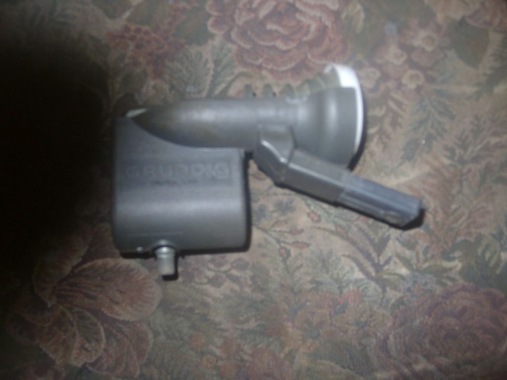

Message posted on 16 Feb 2024 08:13 PM
Re: upgrade from sky SD to skyQ
hi to all
thank you for the info now the lmb that is fitted has only one coaxle cable coming from it and the lmb mounting slides into the arm see photo of lmb
Message posted on 16 Feb 2024 08:20 PM - last edited: 16 Feb 2024 08:20 PM
@mgrover75 wrote:
hi to all
As mentioned by the others & in my notes SKY will replace that & renew the cabling & quite likely the dish as well
