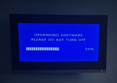

looks like there was a problem with your USB stick or file - mine took about 15/20 mins from memory and the percentage increased regularly

I only had a 32gb usb but I did a partition to reduce the size. I will try with a smaller USB

I have indeed, and after turning the house upside down for a USB stick I'm happy to report I'm back up and running without any issues (so far)
Thankyou to all the contributors!
Update was a lot quicker than i expected (15mins max)

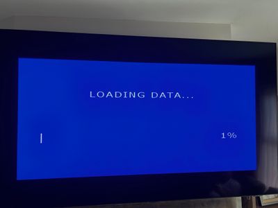

Was it the downloaded folder or file you renamed? Mines stays at 1% when I put the usb in

have tried this 3 times and it doesn't load passed 1%

Finally got the update to work. Been watching the football and so far so good. Phillips did advise me to change some settings but that made it worse and this update hopefully has fixed it

Used a 4gb usb instead of the 8gb
