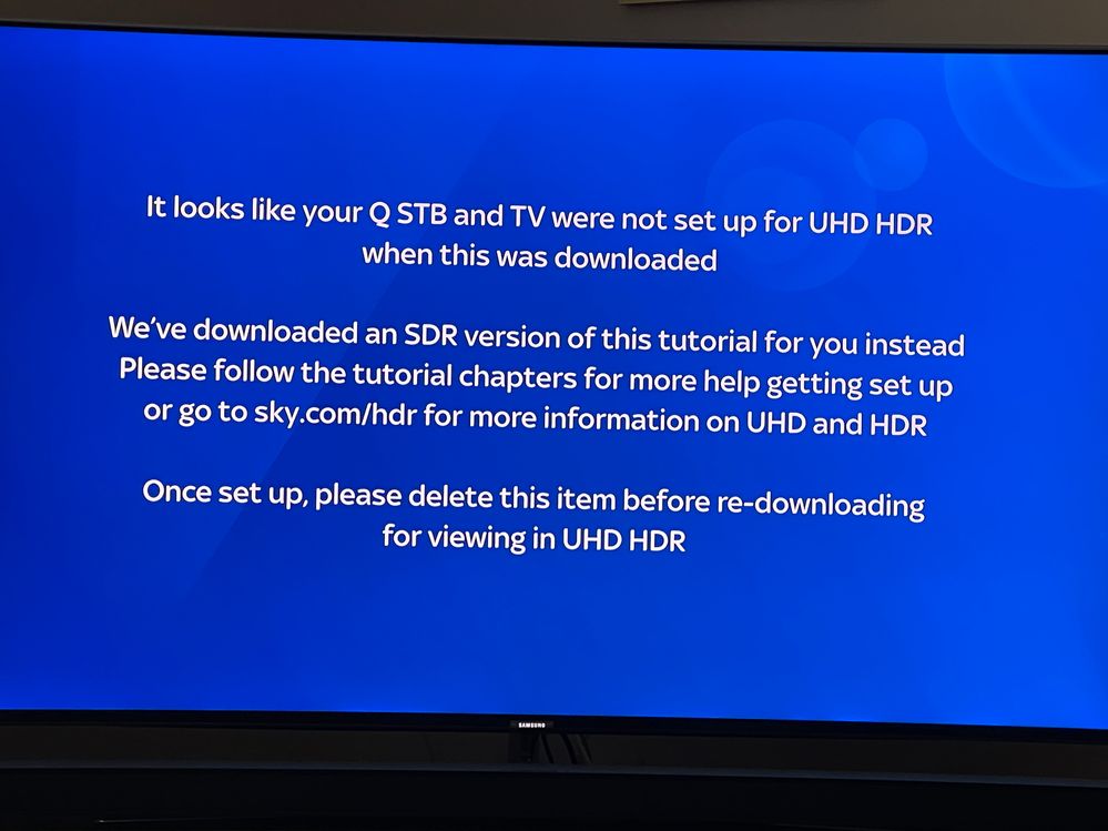

I've just been going through the HDR tutorials and keep receiving this message.
it seems I can watch in UHD but there is a recording issue.

Hi @iwaddo
The message you have posted is not referring to Standard definition..
Its referring to SDR as opposed to HDR.
So that would be still be in UHD but UHD/SDR instead of UHD/HDR
