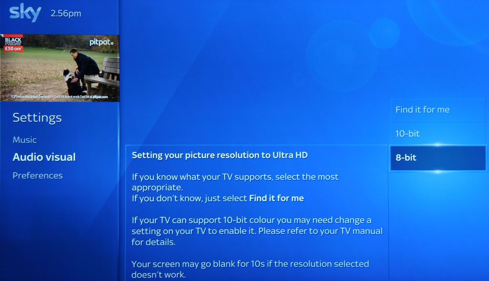

Have you changed display settings? Try changing it from 10bit to 8bit.

Ok... tried settings... won't change off 10 bit UHD...

@Colonicus The TCLQM5K can only achieve a 2% Peak brightness of around 484 cd/m2
The TCLQM6K can only achieve a 2% Peak brightness of around 544 cd/m2
These sets would only produce a dim HLG HDR image, so set your Sky Q receiver to provide a 2160p 8 Bit signal to your TV
Whereas The TCLQM7K can produce a 2% Peak brightness of around 1312 cd/m2
The TCLQM8K can produce a 2% Peak brightness of around 5658 cd/m2
These sets should be capable of producing an adequate HLG HDR image when correctly configured, so set your Sky Q receiver to provide a 2160p 10 Bit signal to your TV
Godfrey.

Try resetting to 1080 first by hitting 'Home 1 0 8 0 Home' and then changing to 2160P/8 bit.

'far too tech for me' you will just have to change your Sky Q receiver to supply your TV with an 8 Bit signal instead of a 10 Bit signal.
