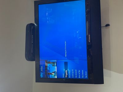

Discussion topic: Waiting for tv schedule message
Message posted on 30 Jul 2024 08:44 AM

Hi @Wendy89 I would start by power rebooting everything, starting with your broadband router. Followed by the Sky Q Main box once it is back up and running. Then any Mini boxes if required.
Message posted on 30 Jul 2024 10:52 AM
Re: Waiting for tv schedule message
If you don't know how to reboot your Sky Q box then
~ Using the remote put your main Sky Q box into standby
~ switch the box off at the plug
~ wait at least 30 seconds and then switch the box back on at the plug
~ follow the on screen instructions
~ when the screen goes blank and the blue Q stops pulsating wait another 30 seconds
~ press the 🏠 button
