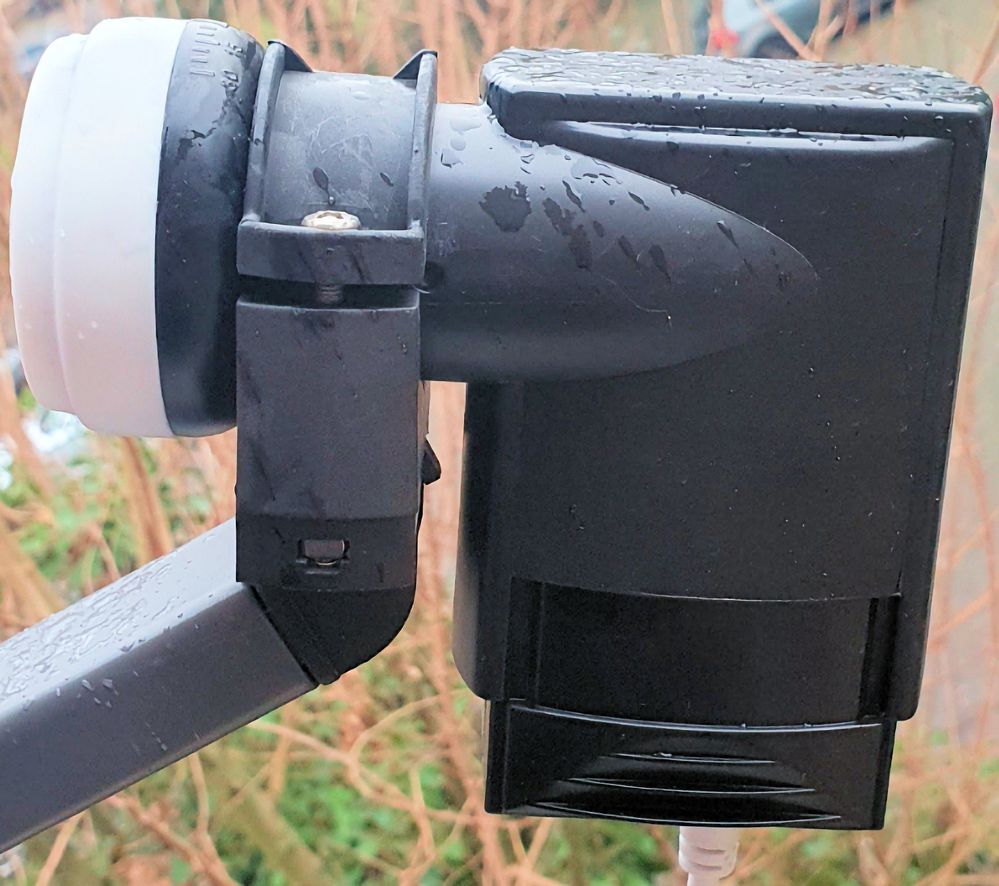

The LNB i have is not that bad, just Incompatible with my SKY Q The same Brand has a big variety of LNB types, but to find the Right one seems not as easy.
Can i use an LNB from this or other brand with H/V and Legacy autput?   For the SKY Q when i use Two Cables for wthe Q.  / Yes/NO/ 😊

the 2 H/V feeds used by SKY Q must be wideband feeds - these use a different oscillator frequency to legacy 'Universal' Outputs as well as providing (as the name implies) a wideband signal rather than using a 22Khz tone to switch between  low & high narrower bands (BTW Universal ouputs change polorisation depending on supply voltage 13V/18V)
The points made by @Godfrey regarding the drop down rain cover and use of amalgamting tape are to ensure that you don't get premature failure due to water ingress etc.

it is so Dificult to find an LNB for that SKY Q??
I had shown you the Posible LNB
A Wideband like This ..
Or a Similar with an extra Legacy output for my Standard Boxes.. I want just let loose my Old SKY+ HD and Use my SKY Q Because the Card is Paired with that.

@Maniatore2006  If the LNB in your last image had been setup with a test meter, for optimal quality, I would have expected the best transponder signal focus position for the mounting collar clamp on the LNB collar would have been far closer to the midpoint position, and certainly not positioning the LNB at the furthest distance away from the dish reflector surface that was possible.

Believe me that is the best Position for the LNB, it works just Fine. Max Reception 98% Min 75%

The reason that I am attempting to guide you into optimising the Bit Error Rate (BER) quality of your received signal is because a Sky Q receiver requires a measured BER quality of at least 11 dB, whereas a Sky+HD receiver only requires a BER quality of around 7-8 dB for continuous error free reception.

I just had ordered the Wideband LNB... With separate H/V

so, das Wideband LNB ist da, und der SKY Q Funktioniert nun.. Aktuell nur eine Ebene weil nur ein Kabel vorhanden, aber das ist das Kleinste Problem.
