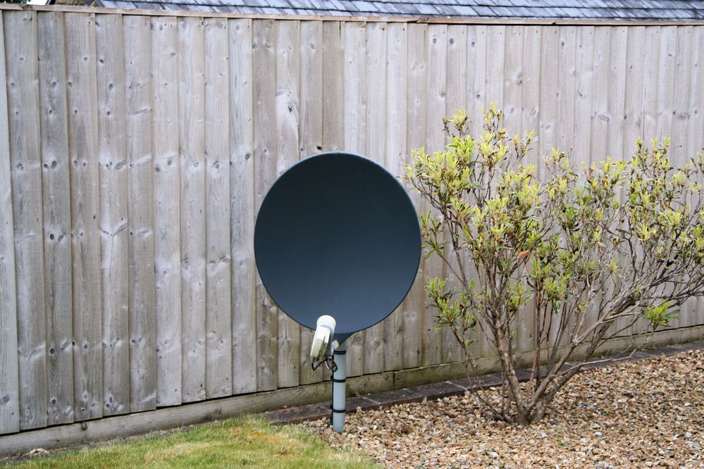

Sky minidishes have a 37.5 mm LNB mounting feedarm collar, standard satellite dishes utilise a 40 mm mounting arm LNB collar, so you will need to source a WIDEBAND LNB that has a 40 mm collar and not try to fit a genuine Sky Wideband LNB.
If you do not have a suitable test meter available I suggest the 'SKEW' angle in this image provides a starting point for optimal reception.
Link to typical retail source; Triax Wideband LNB for standard dish
You might find that you require to use a 'Power Inserter' to power a WIDEBAND LNB and the Johansson adaptor.
If you managed to source one of the Global dCSS LNBs you would find that it achieves a good quality stable SCR signal source when mounted on a dish similar in size to your existing one, this image depicts the test performance I achieved back in 2022 when I purchased one out of curiosity. This LNB would not require the use of a 'Power Inserter'.

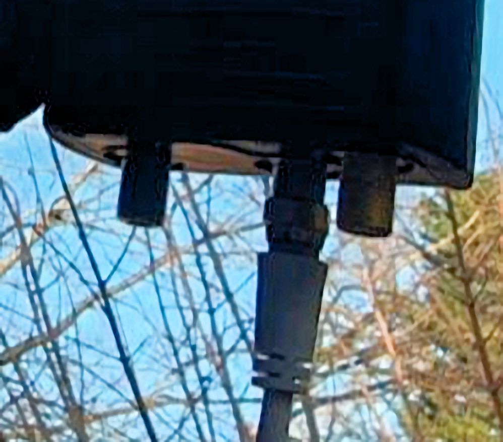

@Maniatore2006 Looking at your existing satellite dish, the LNB is not using a 'Pull Down' rain shield to provide moisture ingress protection to the coaxial cable F connector, nor does it appear to be utilising the previous default method of using SELF AMALGAMATING tape to prevent moisture ingress. Although it may or may not be using silicone grease in an attempt to stop moisture penetration.
I strongly suggest that when you change your LNB you pay attention to make sure that a modern 'Pull Down' rain shield is correctly configured.
