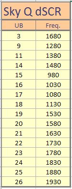

@Maniatore2006   The only source that I can find for this LNB is fortunajersey.com
It is now quite a long time since it was generally available, but this retailer might still be able to order one for you.
Godfrey.
Edit, this LNB is configured to provide the specific set of 'User Bands' required by a Sky Q receiver

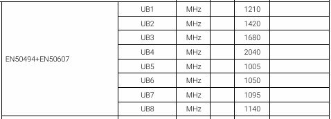

If I remember correctly a Sky+ HD receiver uses the EN50494 SCR User Band protocol, so this LNB is unlikely to suit your Sky+ HD receiver
User Bands provided by a TRIAX TDCSS 024 Gold, DCSS LNB, suitable for a Sky+HD receiver.

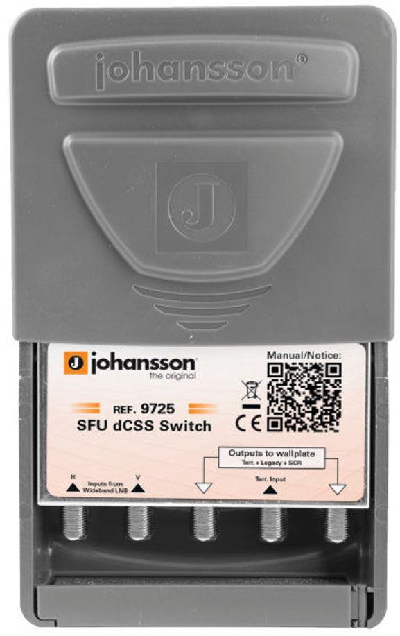

Re: Waht SCR LNB for SKY Q?
@Maniatore2006   The simplest way would be to install a WIDEBAND LNB on the satellite dish, then feed the two outputs into a Johansson 9725 adaptor, which comes in a waterproof housing, installed on the back of the satellite dish, to provide a Single Cable Router (SCR) feed down one coaxial cable to your Sky Q receiver, configured to use SCR LNB mode.
Godfrey.

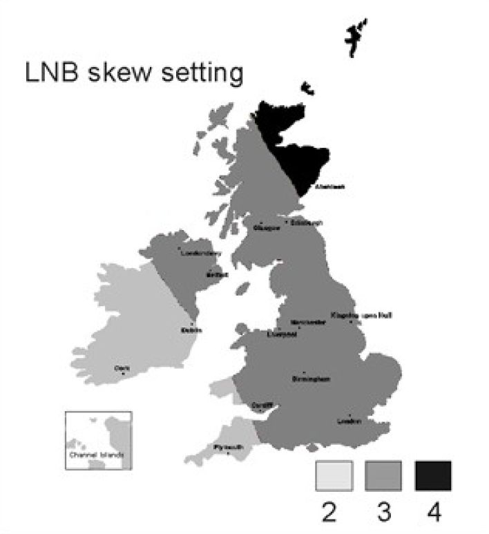

This message was authored by: Godfrey
@Maniatore2006  If you have an existing Sky minidish then I suggest that you source a genuine Sky EL029 Wideband LNB and insert the LNB 'SKEW' peg into the appropriate notch in the Sky dish feedarm.
Godfrey.
