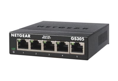

Not an unpowered 'splitter', which exist, but for an entirely different* and irrelevant purpose.
As advised (and counterintuitively) what you need is a powered 'switch'
Something like a Netgear GS305 for about £20
*putting two physically separate 100Mbs data connections down one strand of ethernet cable by using two pairs each.
