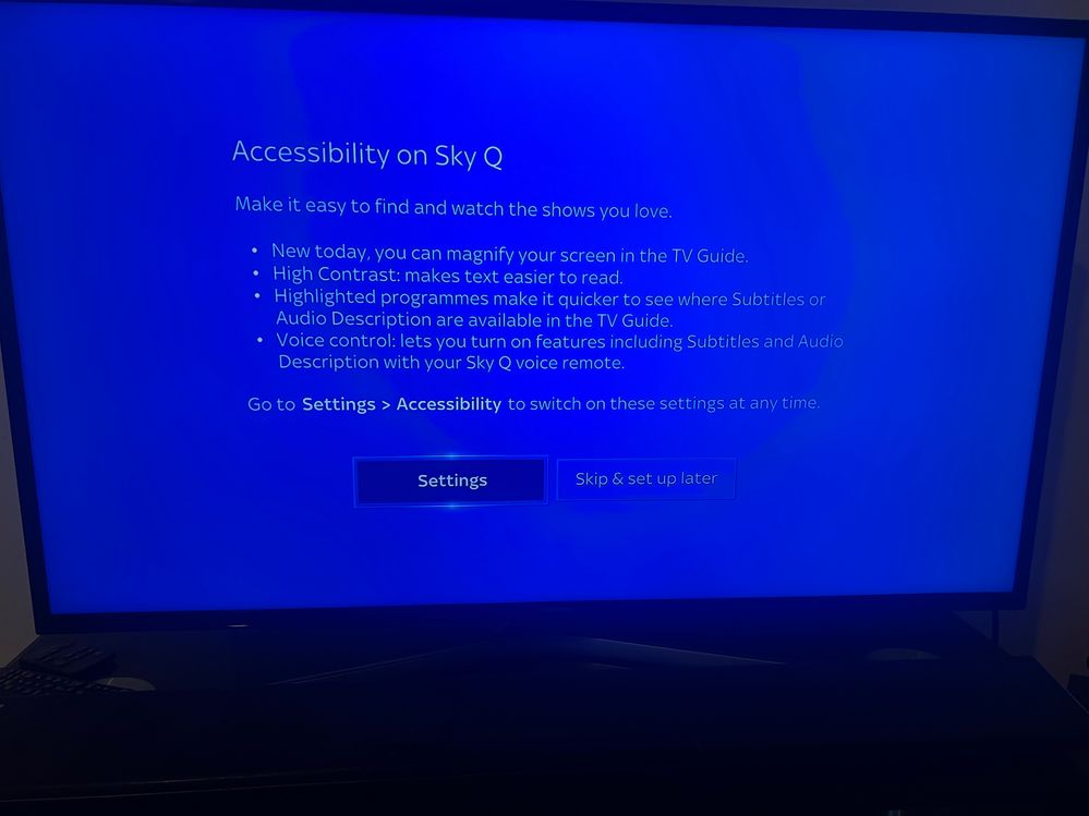

Just had a new Sky Q box to replace an old one which had 'died'
All good with replacing cables....followed the instructions and reached the 'Accesibility on Sky Q'....see pic below ....then unable to get any further. No response on using the Sky remote to get into settings as suggested. Tried a fresh set of batteries....no change....saw one brief flash of red light from the remote.
Then tried to access the Sky box from the MySky app. 'No box' recognised Only one wifi system available here.
Has anyone any idea what is happening (what I am doing wrong)?
Message posted on 09 Dec 2025 03:56 PM
Sky have suggested the following...
- Unpair their Sky Q remote from the box by holding 4&6
- Wait for the remote to flash
- Then dismiss the information screen "Skip & set up later"
- Hold 1&3 to repair the remote control
If 4&6 does not allow you to clear the information screen, try holding 7&9 to reset the Sky Q remote then hold 1&3 and follow the on-screen setup journey to allow the remote to control the TV.
