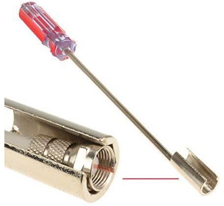

Where can I get something to loosen the connectors without damaging them? the silver nuts that fasten the Sky Q cables to the back of the Sky Q box

@elderwandninja An example of a suitable spanner that slips around the coaxial cable, found after searching for; F Connector Screw Type Coax Plug Long Arm Fastener Screwdriver/Spanner
The top of the handle has a screw thread which is intended to hopefully help restore the internal thread of the F connector nut, if it had inadvertently been cross threaded.

One came with my Virgin Media modem... But you can buy them:
Search for 'F connector spanner' - they're on eBay for a few quid, e.g. https://www.ebay.co.uk/itm/314081254442

@elderwandninja This is a typical example of a suitable spanner.
Typical example of F connector spanner

7/16" wrench. Drop of pentrating oil might help.

Thank you , that's fantastic 👍
