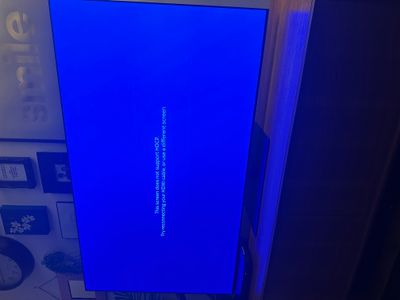

My Sky Q box has been temperamental ever since it was installed last month with the box sometimes finding signal, sometimes not.
It's had HDCP error as well. It's got hot and the fans have been whirring. I've rebooted it and updated the software, however it's now completely not working. Anyone got an idea?
