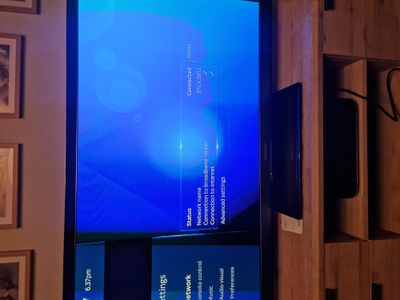

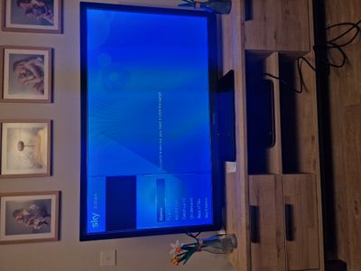

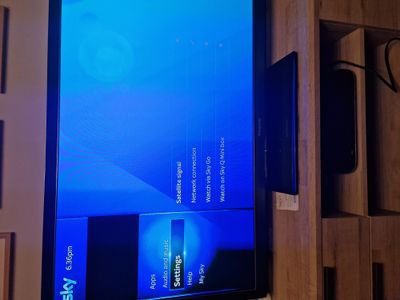

Hi all. Last weekend I lost all satellite signal but my netflix etc apps all still worked. Did all the usual power cycles and disconnected everything and checked all cables. Tried spare cables too. Was suggested to try the softest of the 3 resets so as not to lose all my recordings. Did this and was greeted with no satellite signal for all the menus and even the apps didn't work. Cut a long story short, sky sent me a new box out and I followed the instructions, changed the LNB to SCR and reset. Still no satellite signal. I am on an estate with a central hub and the signal comes through to a GTU box thing. Any help to stop the kids moaning would be much appreciated. Thank you....

If you change the LNB type to SCR in the Q box settings you have to reboot the Q box for the setting to take affect.
Have you tried rebooting your Q box after changing >

Thank you for the suggestion, yes I tried this and no change I'm afraid.

Assume you are on a Communal Dish system and don't have your own dish?
Did you check that the LNB type was SCR after you rebooted the Q box

Yes that was the first thing I checked after the all the problems I had at the weekend. Really odd. Just pulled all.the wires out at the GTU box and left them.for a while and tried again and still nothing. I'll try and get hold of the engineer who looks after our estate and see what he/she can do!! Thank you @oldfella!
