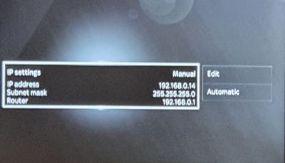

Here is how mine looks when done
Hit the confirm button, and it will give you a list of your manual IP settings like this
For no sane reason the DNS isn't listed but will be in the edit page.
