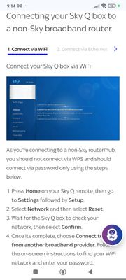

Sky themselves specifically advise otherwise (AI search results may differ)
As you've discovered, WPS works to some extent, but not very well.
https://www.sky.com/help/articles/setting-up-sky-q-connect-to-third-party-router

@Sarah1948 wrote:I haven't found anything to say that I cannot use WPS with non-Sky broadband. It works well and is obviously quicker. I rather doubt using WPS has any bearing on the disconnection issue.
The network reset process specifically says to only use WPS with sky routers. I suspect this is because the Q Box shares the login details it knows about with minis and it doesn't get those if you use WPS.
